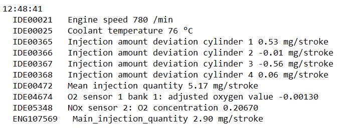

These are readings. Coolant temperature is strange. Instrument reading says 90 deg C, VCDS says 75-76c.
For the smoothified temp. reading please have a look at Plateaufunktion der Temperaturanzeige
Does the engine consume oil? Could it be oil that is burnt and leading to the smoke?
What is the color of the smoke? White, blue, black?
Thanks for that, explains it. I put a new temperature sensor in as it was very cheap. Highest temperature I got after a long drive and sitting at idle was 80 degrees c coolant temp, with VCDS. I think no catalyst probably helps, before blow up I was getting fan running for a long time after stopping. Not anymore.
Smoke is white and burns my eyes. Not water though, I’ve been on long drive and checked level.
Maybe water is „burnt“ only at ildle? (Only guessing, I would not know why or how this could happen.)
