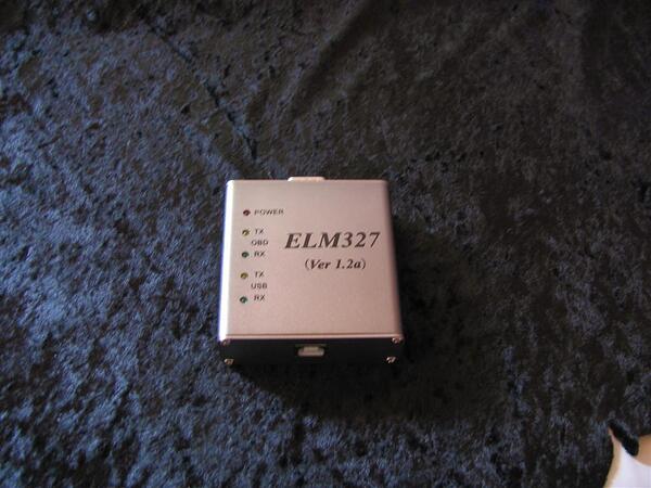

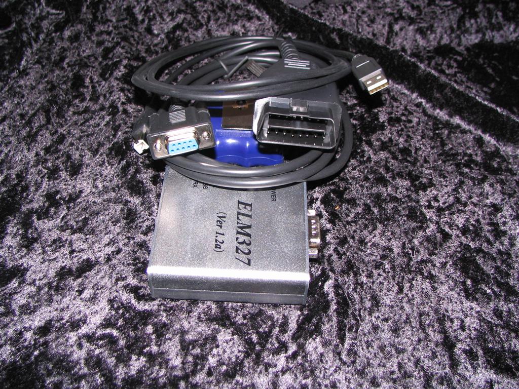

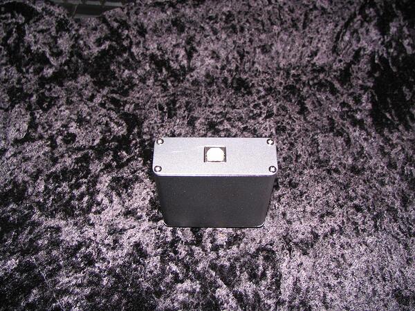

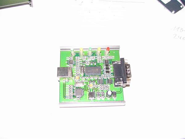

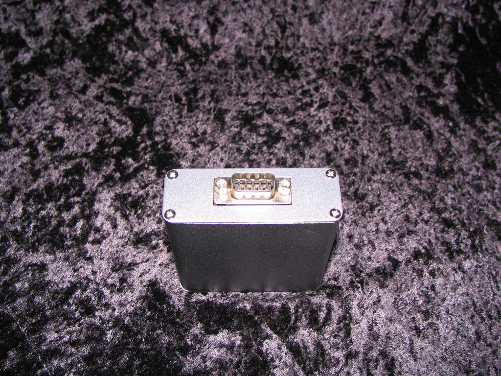

Hier mal ein paar Bilder des Adapters:
 ![ddd8e3887d5389664caa83948d717a44.jpg](https://www.sgaf.de/uploads/default/original/3X/f/8/4/f84bd9f7081015da391b3923a50369015720dff1.jpg "CAN")
 ![b18ed6236fd47d3c8b3393e9cd82e732.jpg](https://www.sgaf.de/uploads/default/original/3X/c/6/6/c667b0c4a7182b34554ca245214149a886e8d35e.jpg "CAN")
 ![8d2b024876d1f08b063af1786b131c7e.jpg](https://www.sgaf.de/uploads/default/original/3X/9/0/0/900b00e45e4488fdc88644c60b42f5971e3f132e.jpg "CAN")
 ![3256ea75b8cd3d6ee8124d1e3196a4d3.jpg](https://www.sgaf.de/uploads/default/original/3X/0/7/0/070f5ce3170095e3f88d11629166342bdd3e68cf.jpg "CAN")
 ![5b0b2c52a90b784743813ff8d09b7d36.jpg](https://www.sgaf.de/uploads/default/original/3X/3/0/4/3046a6f54cf58bfe78f73f80013c3f31179fc562.jpg "CAN")
